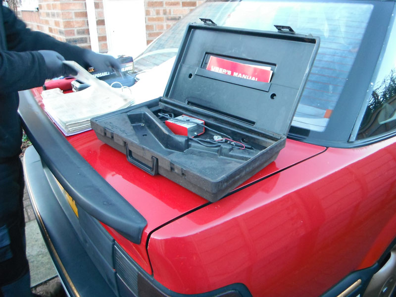

This week began with the installation of an Accuspark Stealth electronic ignition kit to replace the condenser that failed the previous week.
Initially I had set everything by ear and got things close so I could use the car until Mike brought the relevant tools home to set the timing and idle correctly. The Princess doesn't have a rev gauge, so it's necessary to set it with a tool, like this strobe thing from Snap-on that Mike's had for years. The boot of the Rover does make a very good tool table, it's just the right height and size.
Since doing that, the car starts no better or worse than usual. It does, however, drive much smoother with no hesitation. In retaliation, the choke cable has decided that it doesn't always want to lock so I have now had to employ the 1980s staple of a wooden clothes peg for certain choke pull positions.
